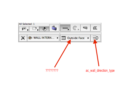

Can anyone tell me if there is a parameter that will display the Reference Line Location (Outside, Inside, Centre & Offset)?
I checked this and what I see is that if you flip the Wall, the WALL_MAT_A and WALL_MAT_B get swapped.
But what I see is that setting the Reference Line Location button in the Info Box to any of its 6 possible values does not affect the above two GDL variables in any way. And I couldn't find any other variable in GDL that would be.
So at the moment I don't have an idea of how this could be achieved.

Is there any progress in this old issue? I have searched for a way to make a label center over a wall regardless of direction and flipped state. It seems that it is necessary to be able to read the outside / inside face setting from the wall. Is this still not possible?

I'm trying to 'get' whether the reference line is in the inside or outside face. The "Is flipped" global variable doesn't achieve much, and the ac_wall_direction_type still behaves the same. Returns 0 if ref line is inside or outside, returns 2 if ref line is centered and 1 if it is flipped regardless of inside/outside, not solving the issue.
Any possible way to achieve this?

WALL_MAT_A is the inside face material of the wall if ac_wall_direction_type is 1 or 3 (consistent with WALL_FLIPPED = 1). ac_wall_direction_type doesn't reflect which side of the wall is the reference line, it tells which side of the wall is the inside face relative to the reference line's direction (whether WALL_MAT_A or WALL_MAT_B is the inside face).
Péter Baksa
Software Engineer, Library as a Platform
Graphisoft SE, Budapest
Turn on the Wall&Beam Reference Lines option on the On-screen View Options palette to see the direction of the reference line. This is not otherwise visible in the settings, but has an effect on the globals.
