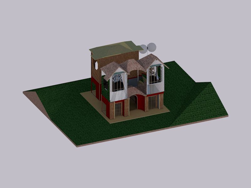

Some template offer both internal and external rendering and some do not , or i mine doing some wrong set up, is it possible to move the entire image to a new template. Someone please help.
1 REPLY 1
There is no need to move the image (model) to another template.
Have a look in the Cinerender Photorendering settings and in "scene" you will see "Select and manage scenes"
Here you can import and export scenes from one file to another.
