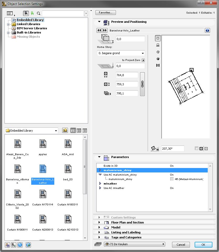

When you import 3ds files you can choose to assign archicad materials instead of the scripted 3ds materials.
These should then stay linked in artlantis with reference files.
It's a bit annoying if the 3ds object had a nice texture applied, but for simple surfaces this should work fine.
Another option would be to import the 3ds in artlantis and save it as an artlantis object (after tweaking the materials), then you can just place the object in artlantis.
