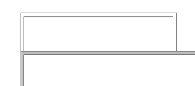

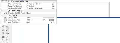

I want it to be expressed like this in the floor plan of core only
LeeJaeYoung

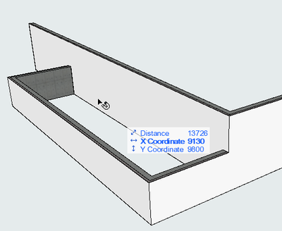

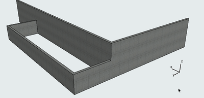

1. Entire Model
2. this is core only
3. this is core only on plan
AC27 on window 11

You have a problem with the finish material strength of the higher wall being stronger than the core of the lower wall, OR you may need to move the wall base lines so the core of the walls meet correctly.
The strength of the finish is weak.
350(finish) - 100(Insulation) - 740 (concrete)
AC27 on window 11
If you look at the 2nd image among the images above, the concrete is connected to each other, but can the strength of the finish be high?
AC27 on window 11
Shouldn't this be okay?
