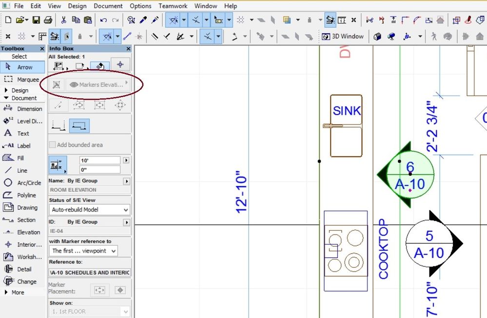

After placing an interior elevation marker on the floor plan, why is it that when I click on it after, the layer is greyed out on the Info Box like it is locked when it is not? This happens only with interior elevation markers and not with the building elevations markers. Any idea as to why? Thanks.

It's because you are selecting just one interior elevation out of a group of presumably four. To change the layer you need to select the whole group.
Any easy way to do this is to right click on the *IE group* in the navigator and choose 'Select Interior Elevation marker on the Home Story and zoom to it'.
Cheers,
Link.
Link, thanks. It worked.
