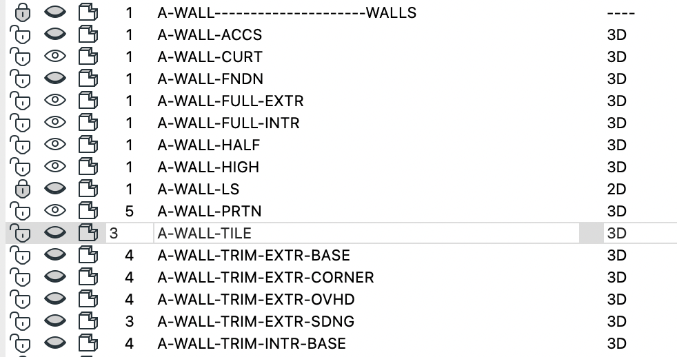

If you deal with this often, A couple of additional suggestions that you can include in your template which will make your life much easier and should not take you more than 30 minutes to set up:
  1. Create a NEW LAYER for this purpose, and give it a different layer intersection priority. (in my case I have the tile wall layer set to 3, and my walls are set to 1)
    Depending on how you model it, you may have problems with the tile wall intersecting incorrectly with the regular wall, and additionally, if you intend to have that wall turned off in some views, it can eat up the regular wall and result in missing lines when the tile wall is hidden. A quick and easy way to solve those problems is by giving the tile wall layer a different "Layer intersection priority" in your Plan "Layer combination" to prevent it from connecting/intersecting with your regular wall. Wall tile-Layer intersection priority.png
