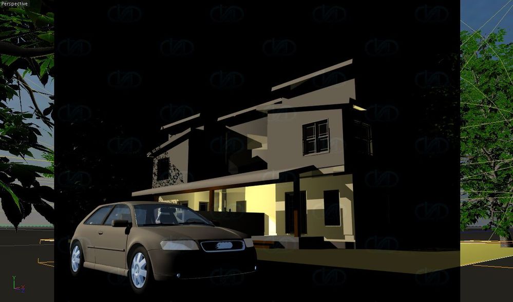

The new Cinema4D 11 is very robust. This physical sky render, with three high poly count trees and a Dosch Detailed Car. 12 min on an Octo-Mac. Nice and quick. Maxon you are the best!
http://www.doschdesign.com/products/3d/
http://www.Maxon.net
This is another way of test rendering software, throw the works into the picture and see if the:
1) Editing environment bogs down to trash - No C4D remained fast and easy to work in ( past tests like this caused Maxwell Render editor to choke )
2) Rendering time went logarithmic to heaven - Again, no C4D cranked through the global illumination radiosity solution within 27 minutes.
With C4D you can realize your vision for the render.
owen

I don't think I would agree with you on that suggestion. The VRAY plugin looks nice, I have installed it and tested the same scene as shown above. However it is not a straight use product. It seems very technical in its controls and there is no doubt a learning curve associated with it. Then there are the plugin/upgrade issues. If a new user sticks with C4D and Advanced Render I feel their life will be more trouble free.
And yes, if you load the VRAY demo scenes you end up with an impressive image, but what combination of textures, lights and settings produced the image? Rendering (the proprietary scene in C4D Advanced Render gives equally strange results)
owen
Each to their own .. I actually found VRay much easier to learn than AR, maybe because it is based more on physically correct lighting than AR ... so for example the VRay Camera Tag has settings such as Shutter Speed, Aperture and ISO like a real DSLR. Being into photography I find this works the same way i think, so maybe that is why i found it easier.
Regarding the tests you did, you have encountered the only real downside of VRay and that is it really requires separate materials and lighting setups to Cinema's internal engine (or the AR). If you disable VRay rendering but your scene has been set up with VRay materials, cameras, etc you will get the results you have encountered. It is the same the other way around .. things that look good in AR will probably look ordinary in VRay.
