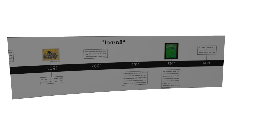

I am having trouble with reversing my image texture on my bent wall. It is showing the wrong way/mirrored.
It is fine on a straight wall, but when I bend the wall with a curved angle, it gets reversed.
Does anyone know how to fix it?
I have tried mirroring it on the x and y axis in the cinema engine, and setting diffrents directions in the internal engine.. None of this does it.

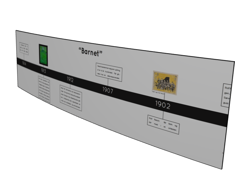

This is how it is now
If nothing else helps you can simply duplicate the image used for the texture in an image editing application, then mirror it and use that image on the Wall.

Thank you!
So easy solution, but my mind is not working properly due to exam stress.
I didn´t find any solution in Archicad though, but mirroring it in Photoshop should be no problem.
So thank you
