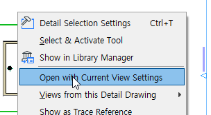

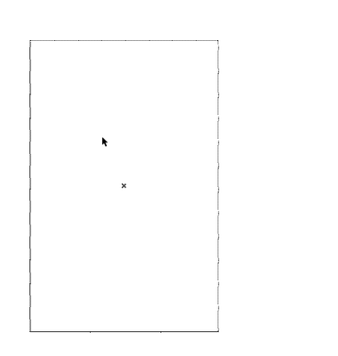

I've been wondering for a long time, but if you use detail, one detail view is created like the right side of the image.
But when I open it, nothing happens.

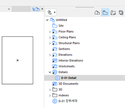

Open with open with... and save as view.... So what's in the detail folder?
What did I do wrong?

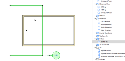

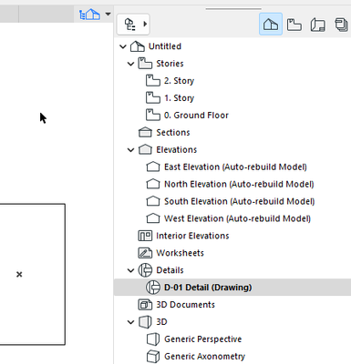

1.  detail click
2. nothing in Ground plan
of cource
nothing in here
AC25 5010 on window 11

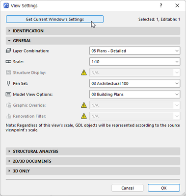

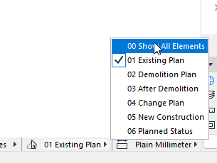

Did you check the renovation status? Most of the time detail tool, doesn't handle it correctly
Cannot be set.
If you change it like this, it goes back.
then
Are you saying that automatically generated detail views cannot be used?
You can use the automatically generated details, but you can't handle the renovation status correctly. Most of the time it just works, but some day you don't know why it stops working.
The only work around for me is to create a new view and replace the one that doesn't work anymore on the presentation.
I don't understand why I put things that I can't use.
I can only think of it as a bug in my eyes.
Why doesn't Archicad fix it?
