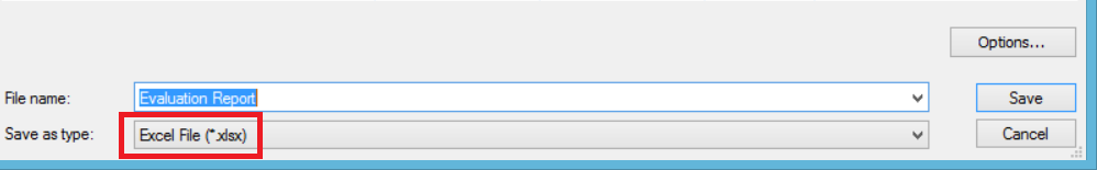

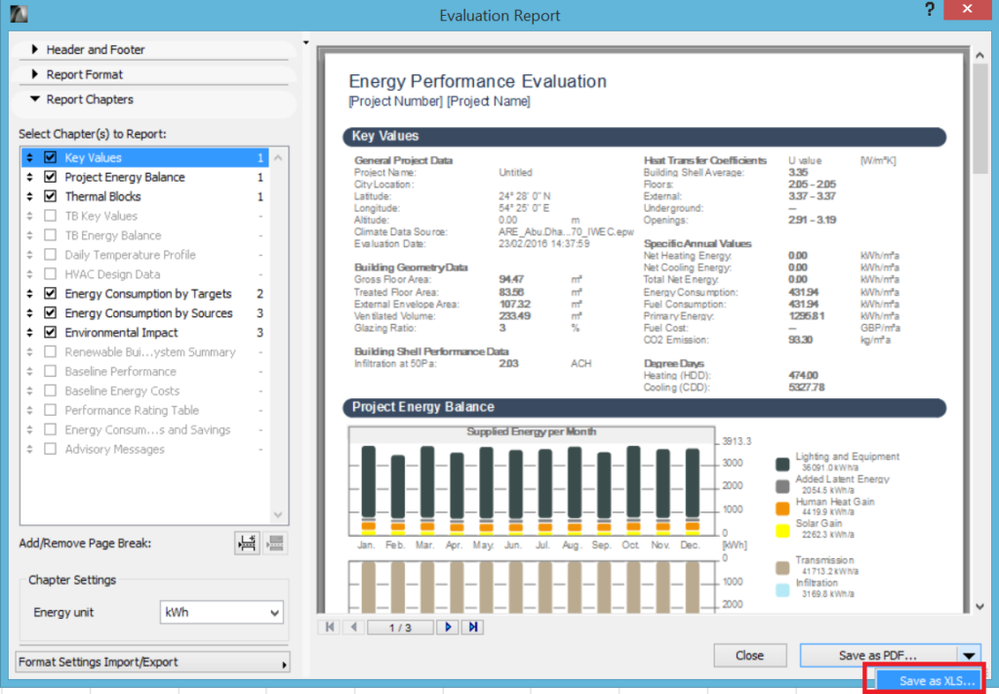

If the Energy Evaluation Report is exported using the default .xlsx file format it becomes corrupted under certain circumstances. Files of the same format can also be corrupted when saved from an Interactive Schedule.

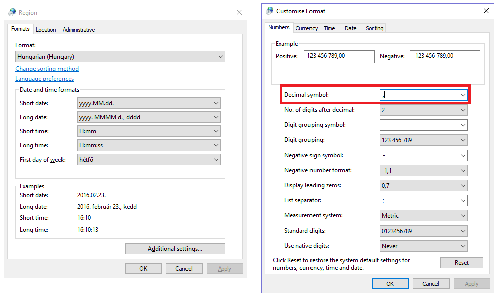

- The decimal symbol is set to “,” (comma) instead of “.” (dot) at Control Panel -> Region -> Additional Settings -> Numbers tab either by the user or by default. This is the default setting of Windows in some languages.

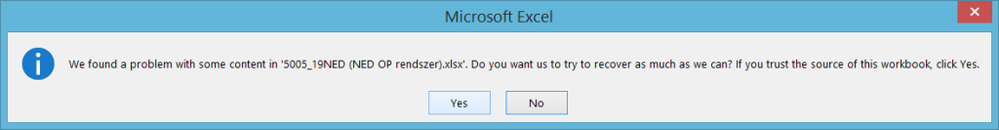

When opening the exported file in Excel, it gives a warning:

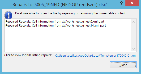

After clicking on ‘Yes’ Excel will try to recover the file and will open it giving this message:

Workaround #1
- Set the decimal symbol to “.” from “,” at Control Panel -> Region -> Additional Settings -> Numbers tab
Workaround #2 only in Eco Designer Star
- Use file format .xls (Excel 97-2003 Workbook)

saved as xlsx |
saved as xls |
Interactive Schedule |
corrupted |
corrupted |
Energy Evaluation Report |
corrupted |
OK |
PHPP |
OK |
