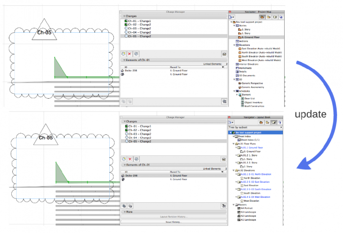

Auto update drawings do not show current status of revision
Affected version: 18 | Severity: workaround applicable | ID: 174437
Note: This issue was fixed in ARCHICAD 18 Update 4020.
Issue
The sheet does not automatically update even in the case of auto-update drawings, unless we navigate to the layout in question. Thus when a change happens, the layouts will not show the current status right away.
Solution
The update has to be "forced" with printing/publishing or a manual update.
