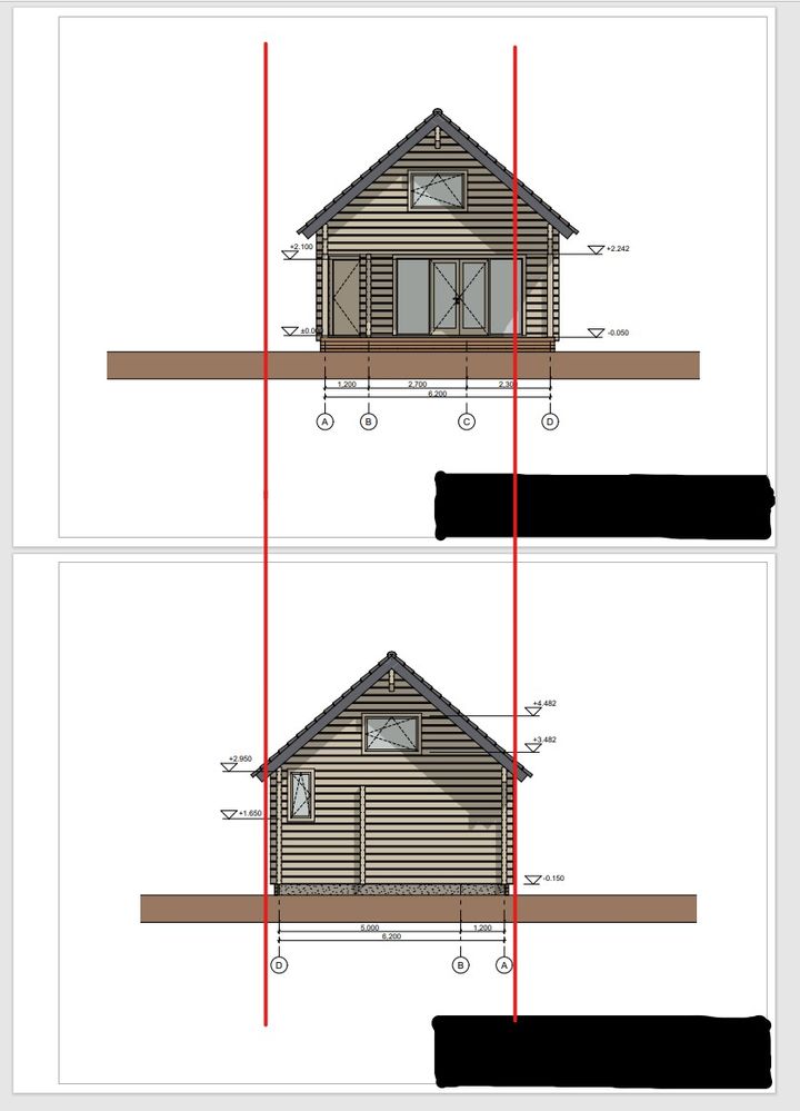

Hey!
Does anyone have a trick for aligning different drawings in seperate layouts? Or inserting drawings in the center of the layout.
I included a picture for better description. These are two elevation drawings.
Thank you!
AC25 Windows, Europe

David Maudlin
RainV:
One option is to place a Hotspot at a common point (top of gable, grid marker, etc.), then select it and copy it to the other Layout, where it can be used to locate the second drawing on that Layout.

Thanks!
Didnt know that hotspot thing.

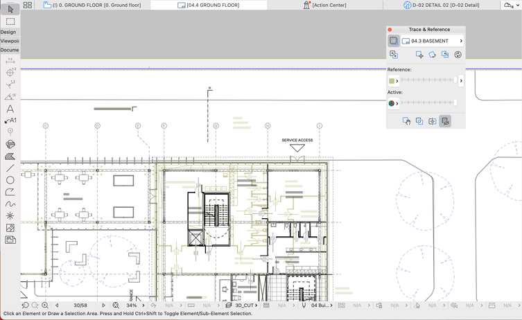

Rubia Torres
Hi @RainV ,
You can also trace reference another layout and align the drawings accordingly.
Rubia Torres
Community Specialist | GRAPHISOFT SE
