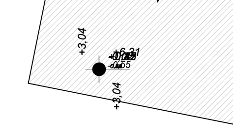

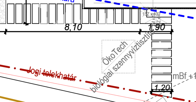

The altitudes on the site plan are correct in the view map, but as soon as i put them on a layout, they get bunched up in one place. Is there a solution to this?
view map:
layout map:

Is the view placed on the layout on a different scale?
a week ago
That was my thought.
We seem to be looking at two completely different views.
Where are the slabs and the red dashed line?
a week ago
Just a guess: is your project modeled very far from the Project Origin?
a week ago
I suspect the 3rd screenshot it just a different part of the same View from the 2nd screenshot, though the stack shown looks incorrect given the mismatched symbol fill and text position...
