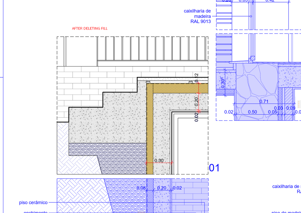

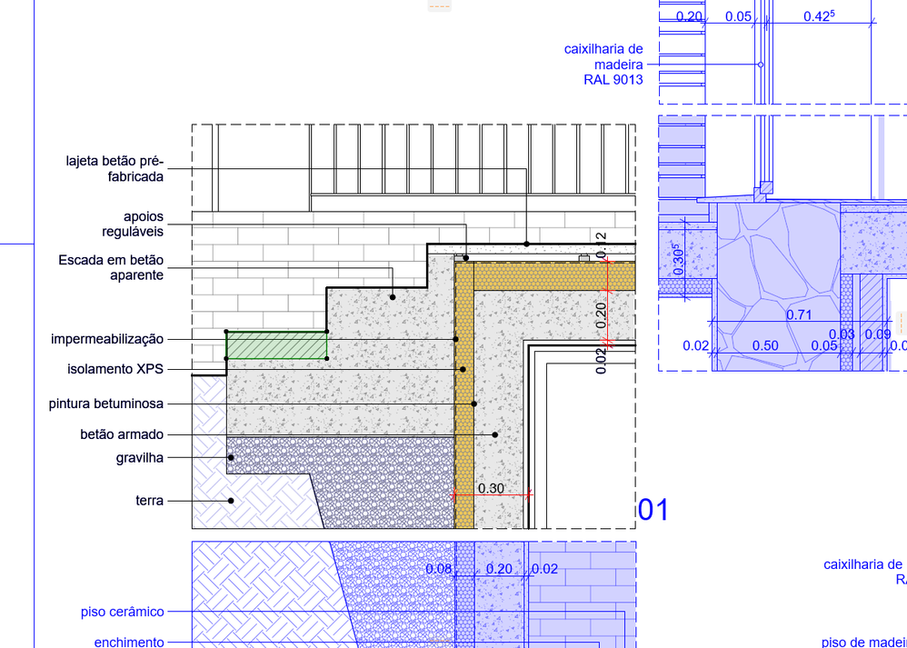

im having a weird behaviour that I cant seem to wrap my head around:
Im trying to delete a simple "fill" from a detail drawing. After i do so, it is deleting all my annotations. I tried to see if it was a group, it is not. i cant figure out why.
Cheers,
Z

If you hover your mouse over the label to highlight it (not select it), the element it is associated to will highlight as well.
To un-associate a label, right click on it and choose 'Convert to independent label'.

Are the annotations actually labels associated to the fill?
Tuesday
Hi Barry!
They are Labels/Autotext features. How do i know if they are associated with the fill, and if so, how can i make them independent?
Cheers,
Z
Tuesday
Tuesday
Done!
Thanks a lot Barry!
