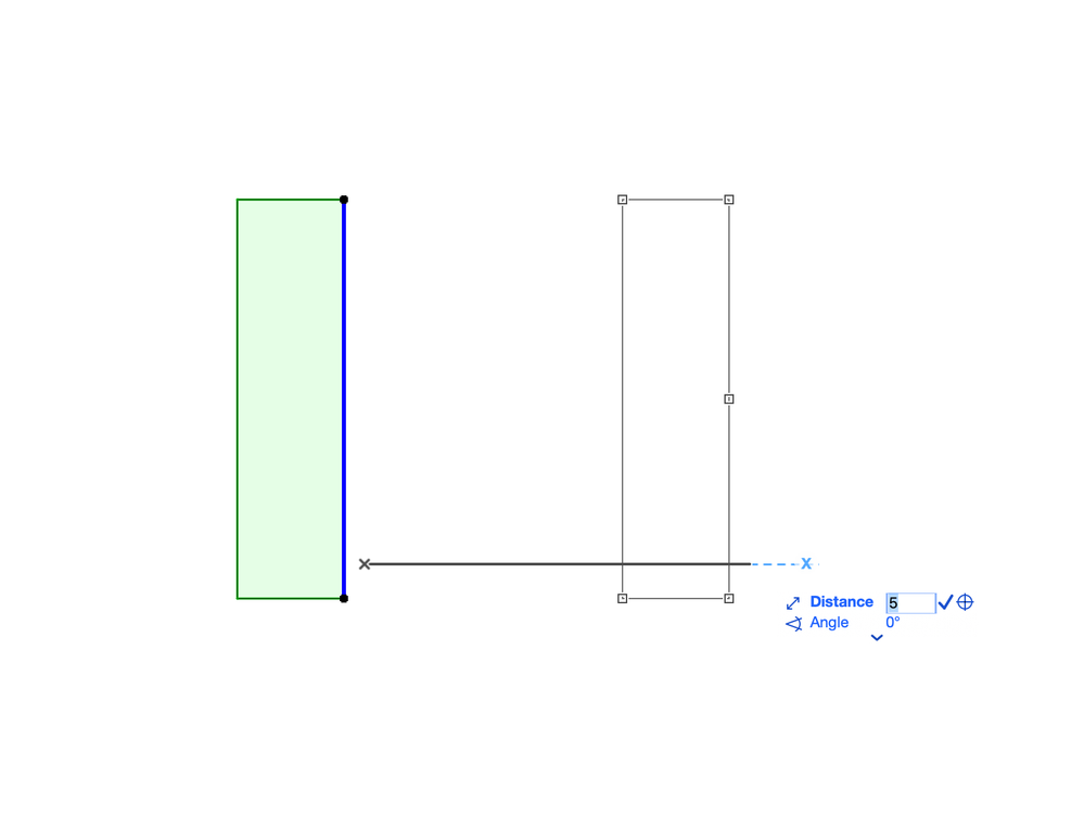

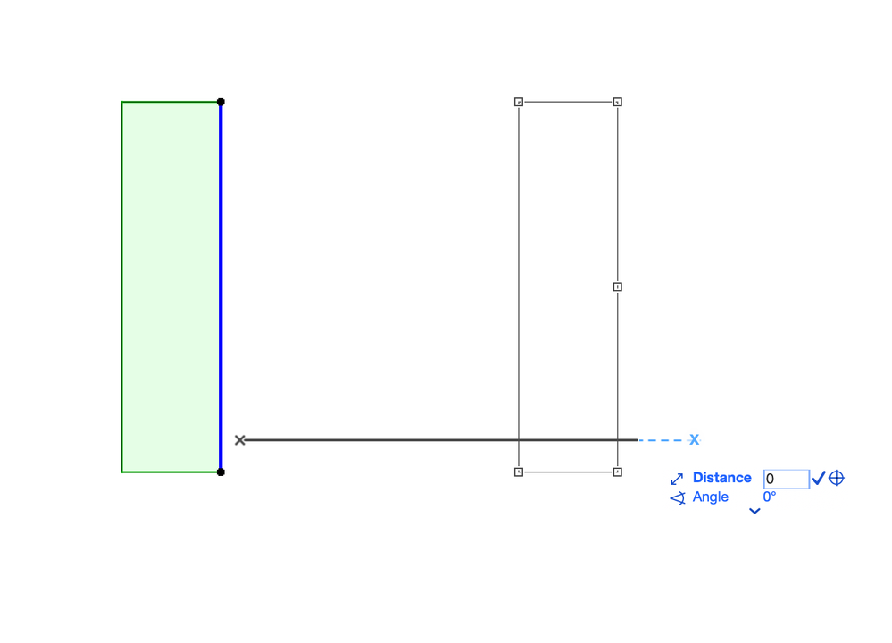

hello, I would like to ask for your help and opinion regarding the problem experienced by a user.
For example, when we want to drag an object 350 cm, Archicad do it 350,  and deletes the number 3 and applies the process as 50 cm.
or we want to draw a wall 680 cm long. but it removes the number 6 and treats it as an 80cm long wall.
This problem is experienced on mac device.
Thanks for your help

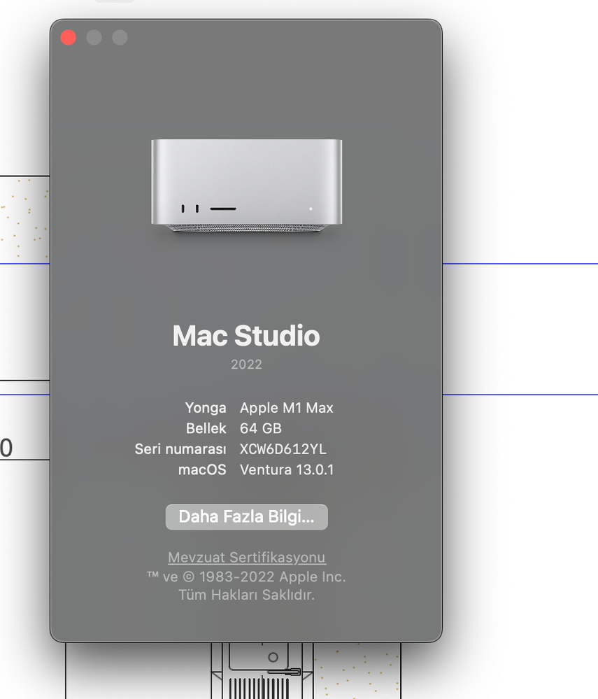

I am assuming you have Ventura operating system?
If so, it is a known problem with Ventura.
https://community.graphisoft.com/t5/Setup-License-articles/macOS-13-Ventura/ta-p/359447
3 REPLIES 3
Solution
