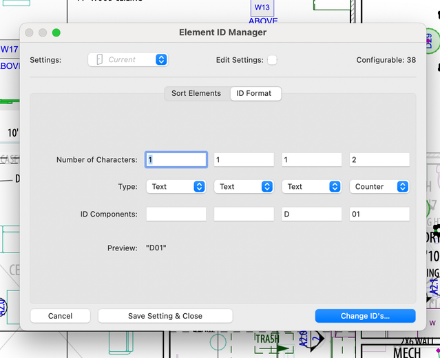

Our office works in residential homes, and we will often add or remove windows/doors with a revision. When working in Revit, the program automatically starts the numbering at 1 and con't, changing the numbers appropriately throughout the project- adjusting the element id by plus or minus 1.
For example-I am working on a home that has 50 doors currently scheduled. We are adding a new door that would be D25. I want to place the door and Archicad automatically number it D25 and change the doors numbered 25 and higher to all increase by 1. Currently we are selecting each door and renumbering with element ID manager. However this can cause various issues easily and there has got to be a way this works!
In my work environment has "Assign New Element ID to Each New Element" selected.
My element ID manager has "Unique ID for Each Element" selected and Element ID is not in the selected criteria.
I have a number counter in my id set up.
Can someone please help me figure out what I'm missing?!

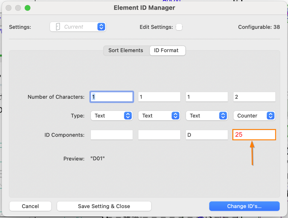

Hi @JKL
You can change the counter number from which to start numbering the missing IDs.
More information available HERE.
Best regards.

Yes, this is how we currently re-number. But you have to go in and select each door in the order you would like them numbered, I am wanting to figure out how to get the door inserted and all of them numbered correctly without having to go through the whole project and select each door/window every time we add or delete one.

Unfortunately, selecting them in the order that you want them, is the only way to re-arrange them.
Other than manually editing ID one by one.
