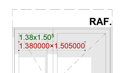

    shpendazizi
    Hi, thanks for the quick reply.
    I don't know if this is the right thread but this is the closest one I could find to my problem.
    In the attached screenshot with green, you can see what I want my autotext to say, and with red is what it's showing right now.
    Hope this helps
