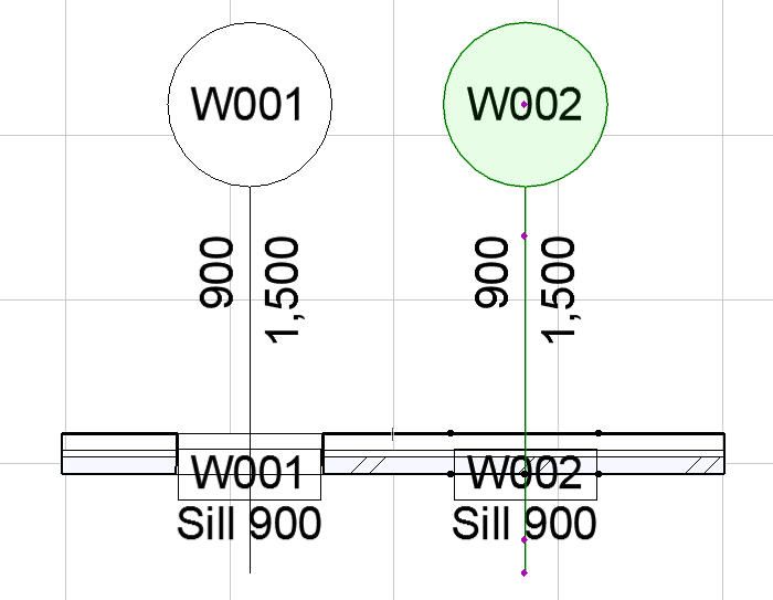

I just loaded the standard Archicad library (I don't usually use it) and found that the windows do have an option to turn off the 2D Detail level in the General settings section.
And the markers/labels remain on when the 2D is turned off.
The window is still there and you can still select it if you can guess where the nodes are.

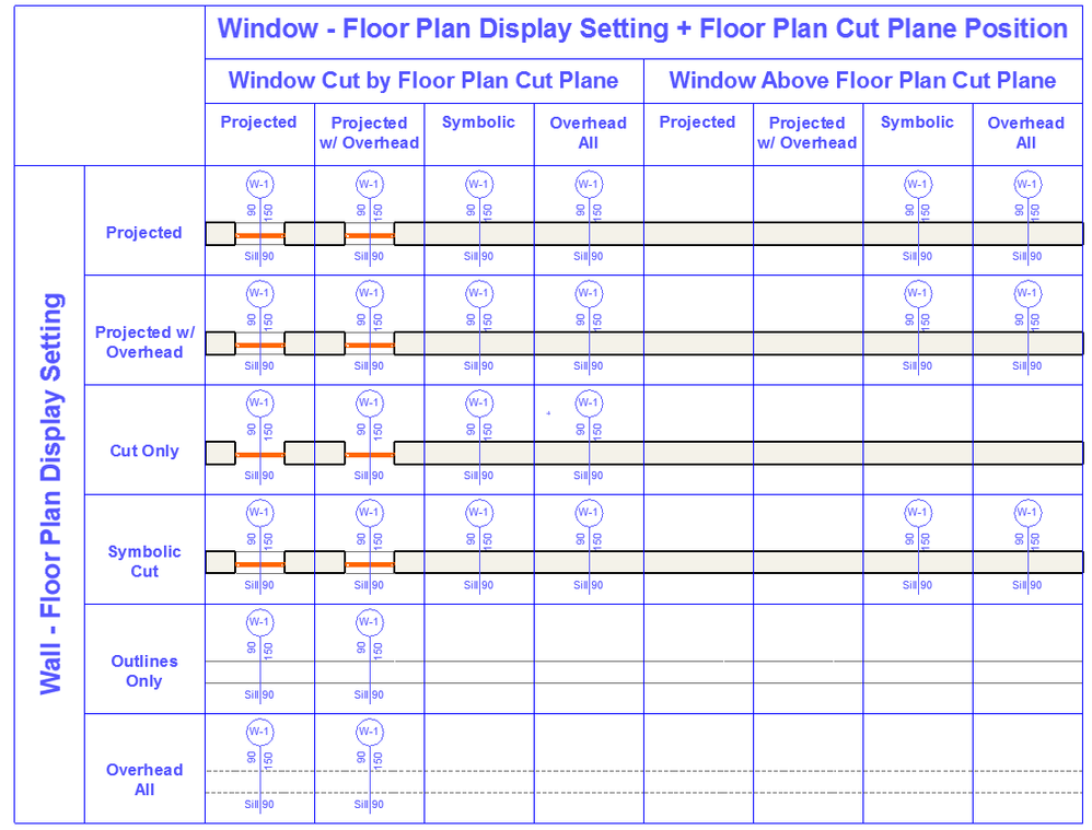

Barry wrote:
I don't know about the dashed markers as that would depend on the marker you are using and what settings it as.
But it seems that unless you display the window in plan you can not show a marker for it.
I did a quick search for 'clerestory' and this is just one of the posts ... http://archicad-talk.graphisoft.com/viewtopic.php?p=157750&#157750
Laszlo might remember making this chart - it was a while ago but I don't think anything has changed.
It looks like a few things changed since that chart.
So just for fun I have recreated it. See the image attached.

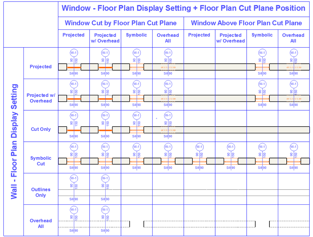

And here is another visibility matrix that shows how the Window and Window Marker are displayed when the 2D Detail setting for the Window is set to OFF.
Unfortunately, there is no settings that could set the Window Marker line type to dashed.
