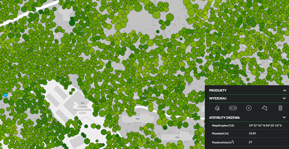

Hi, I feel a bit silly asking this, but I've been struggling for so long and haven't found an answer anywhere. I'm looking for coordinates on a map. I have a geodetic point set up and I'd like to place a few trees with specific coordinates in relation to it. How do I do this? I used Google Translate, so I apologize for my English 🙂

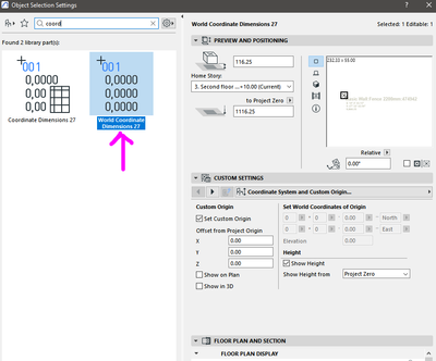

If I understood correctly - you want to place a tree you know the coordinates of?
Firstly, you have to define your project origin in relation to world coordinates. Let's say project origin is at the X Y coordinates you have in your image.
And then you can do some calculation based on that, to calculate the distance on X and Y axis from the origin to place your tree.
You can place this object from the library to double-check the accuracy:
and place as many of these as you want. Afterwards you can replace them all with trees.

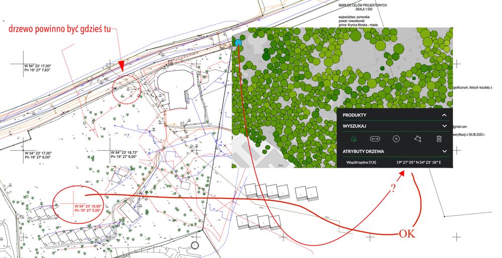

I tried, but it seems I have the wrong data, as you can see in the attached image. Thank you for your help - I understand what the settings are, but I need to solve this problem with the tree map service provider.

Based on your screenshot it looks like you are trying to work with longitude and latitude. You would need to work with Eastings and Northings as these are a flat plane x and y mapped co-ordinates.
With those co-ordinates you could then determine to co-ordinates of each tree relative to your Archicad origin and place each tree manually.
To automate the process of placing the trees based on their co-ordinates you would need to use grasshopper (or maybe python/tapir) as Laszlo described.
