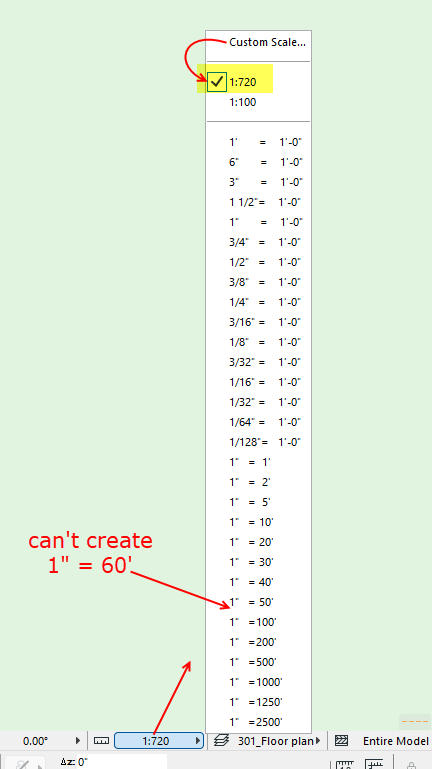

Is it possible for custom drawing scales like 1"=720" to shows up as 1'=60' on view title without overriding with a fill and text?

We are using AC 27 USA 6000. Imperial units.

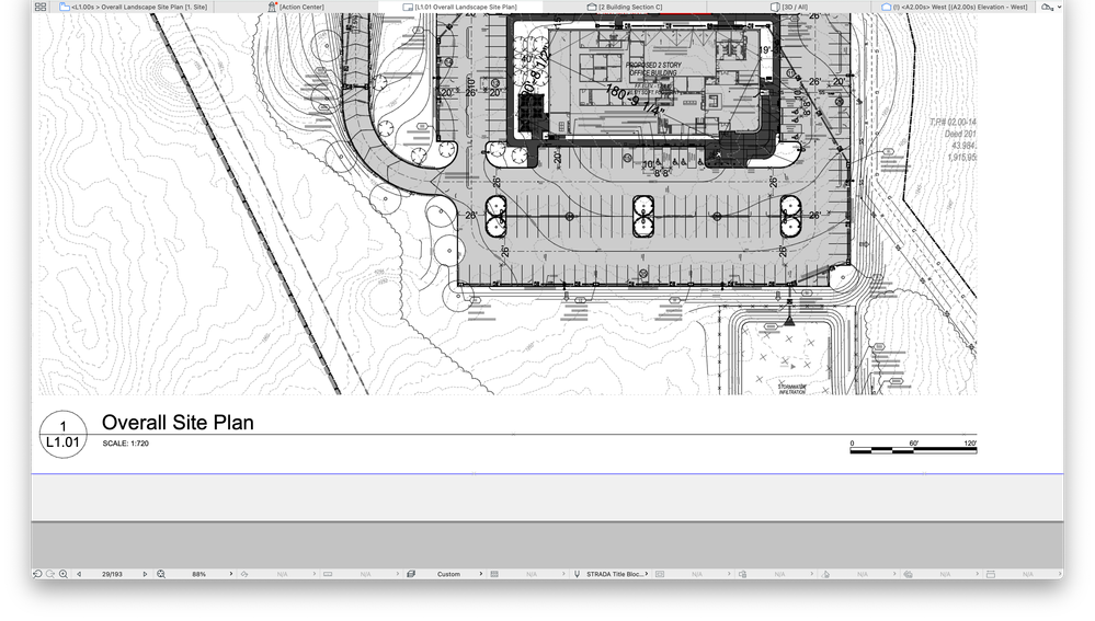

Our Architecture company includes Landscape Architects and Civil Engineers and their plans typically need scales to show full property and lot locations. 1'=60' is a traditional engineering scale.
I would like the scale that shows in 1"=720" inches in the title block to display as 1'=60' feet. It seems possible since the graphical scale shows correct units in feet.
Currently showing 1 Foot = 720 Inches and would like to display 1 inch = 60 Feet.

If the scale says 1 inch = 720 inches then it would also be 1 foot = 720 feet.
I think what you are trying to say is you want 1 inch = 60 feet (1" = 60') - which is not what you are typing.
I don't use imperial measurement, but it seems it can use a scale of 1 inch = x feet.
So 1" = 50' for example.
It seems that there is not a standard scale of 1" = 60'
You can create a custom scale of 1:720, but I see no way to create 1" = 60'
I am not sure where that list of standard scales comes from - I looked in registry, but couldn't see anything.
So, unless there is a way to edit this list, I think you are stuck with manually overwriting the text.
