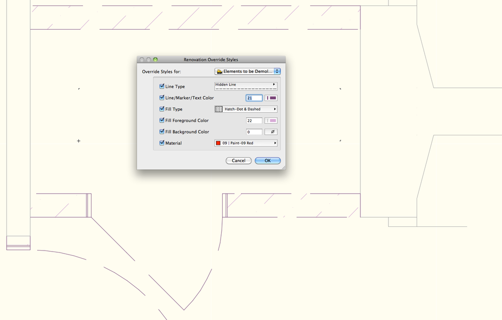

Something I haven't yet been able to work out with the renovation filters. I have a wall that is to be demolished, and it is set to the "To be demolished" renovation status. When I see the plan in the "Demolition" renovation filter, the wall doesn't show up with the hatch/ fill that I want all of my demolished walls to show. In the "Renovation Override Styles" i set the fill types to my desired hatch and color, but the walls do not change to that. The demolished walls accept the new line type and color that i want, just not the fill. See the picture.

Is your wall originally a solid-fill of some kind (25%, etc)? If so, you may have run into this bug:
http://www.archicadwiki.com/Bugs/SolidCutFillAndRenovation
Or... maybe your Model View Options have fills disabled...
