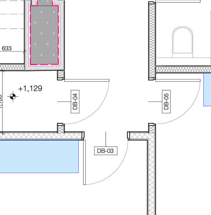

We have an odd thing going on with a teamwork file.
Door and Window markers do not appear in layout view.
However, right click, open source.... and they appear.
The model view option of the saved view is correct. Door and window markers are set to visible.
Any idea what could possibly cause this?
All advice appreciated.
Tom
11 REPLIES 11
are all windows set to symbolic? or are they projected or projected w/ overhead?
I found the problem: it was the renovation filter. The box that reads "hide opening dimension marker" was checked.
