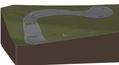

I've been playing around with Rhino - Grasshopper Live Connection and been able to generate morphs which follow the topography of the site.
A colleague looked over my shoulder and made two comments which resonated quite well.
Said wow that functions really well and we'll use it often.
Then said how come it's that complicated to create a sloped driveway in Archicad.
Kind of a valid point, as cool as it is to play around with grasshopper, why does it take that level of knowledge to have a paved surface (or any other surface for that matter) follow the mesh.
Now there's options like copy the original mesh, raise it up, cut it etc. But any one that's worked with even small scale roadways etc knows how messy (and sluggish) this gets.
Anyway, not really a question, more an observation and be interested to hear other users views on the subject.

I think following a mesh is an overly simplistic solution. These hard surfaces should be formed with a tool that allows for surface build up, variable widths, shapes, cambers, horizontal and vertical transitioning, and the formation of kerbs and drop kerbs. The tool should be able to set gradient limits and manage transitions to acceptable values. Road design is a specialist discipline, but it would be helpful in AC if there was a way to at least create a basic representation of a hard surface with realistic shaping.

It's a useful video from @James B but it does miss the fundamental issue that paving is no different to adding a building. The paving is a structure and the terrain is typically cut and filled to meet that structure. I have had a look at a few videos but they all miss the fundamental point that a path is formed on the XY plane, but the Z values must form a smooth curve, without it the modelled levels can be far from what will be constructed on site, if that doesn't happen the client will be very unhappy with the localised flooding and the repairs to his Ferrari when it grounds on an apex of two slopes meeting.
The other aspect is the path should have a consistent thickness, but the profile will constantly vary, kerbs either side of the path will need to rise and fall according requirements to manage rain water and forming appropriate cambers for corners. The path also needs the ability to merge with other paths at junctions which can form complex surfaces.
Basically paths / roads / hard surfaces are freeform beams and this is why there should be a dedicated paving tool.

GS has been told they should just buy the LAND4 add-on which has amazing functionality around mesh creation and editing. It would be a very quick way to add the functionality a lot of users have been asking for and all they have to do is write a check. Going by Nemetschek's Linkedin posts they are seemingly not short of money! I have personally supplied them heaps over the years😋

@Erwin Edel wrote:
If curved beams could slope, we'd be half way there.
Just like the railing tool does.
And it is associative to the mesh if you want it you be.
