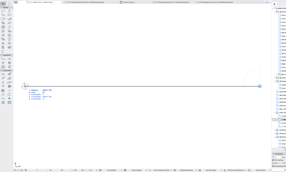

That fixed it!!  I had a wall that was 243,071' long!
Thank you for the help
