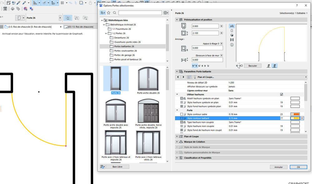

Do you mean that it's easier and more efficient to work with pen & styles (model view) and apply it to openings or wall settings like this (attached screenshot) rather than using graphic override?
Why and when do we use graphic override then, for hatches?
Lee Hankins
That's right. Graphic overrides are more used to display graphical information based on rules from properties. As an example, each element can be assigned a fire resistance rating be it 30, 60, 90 or 120 minutes. We use graphic overrides to generate our Fire Strategy Plans so that all fire resisting construction is overridden on those plans to display the defined fill types and colours associated to the property of either 30, 60, 90 or 120 minutes. We also use them for demolition plans. on all of our standard general arrangement drawings and other layouts the demolition appears grey dashed as per the renovation filters but on the specific demolition plans, everything that is identified to be demolished is automatically changed to be red dashed along with the associated notes which change to red. We also have floor finishes plans where on all working drawings the zones appear with a transparent cover fill. A property is applied to the zone which tells it which type of floor covering it has. We then have. series of graphic override rules that change the cover fill pattern of the zone and the colour to match a predefined key which then displays the type of floor finish.

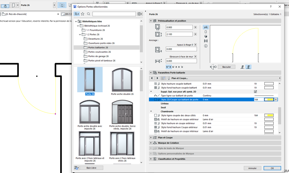

I was wondering, is there a way to speed up the process of changing windows/doors/walls pen colour or is the manual approach of selecting all doors (for example) and changing the pen colour in Plan/Section parameters (attached screenshot) the only way to do so ?
If you want the colour to affect every view, then change it in the object.
Use the GOs to override particular views.
That way you can have 3 plan views that all look different because they have different GOs, if that is what you want to do.
But remember a GO will override the colour of the entire element.
You can't have a GO change just the door leaf colour, it will change the entire door object - door leaf, frame, swing lines, etc.
