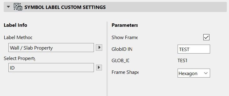

I went down the rabbit hole of modifying one custom GDL label and played around with GLOB_ID which should be the element ID. I plugged it in the interface script. First field (globID IN) is a parameter (glob_ID_IN), then I do GLOB_ID = glob_ID_IN, and in the next line I print the GLOB_ID. It Prints whatever I input so I am assuming I am actually changing the ID of the label? But perhaps not since GO is still not overriding the label.

GLOB_ID is a read-only parameter in GDL.
It is not possible to set the value of GLOB_ID, and therefore the value of the Library Part's Element ID from the GDL Script.
