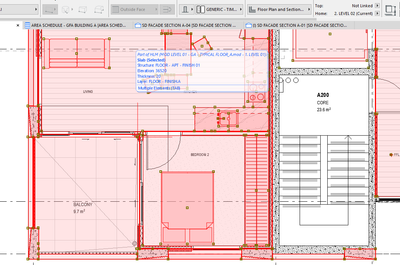

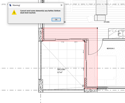

I got this typical floor module that I placed on the above levels. I got one slab I can't manage to place behind the hotlinked mod. I try to send it back but I got the message saying it's as far it can go. I've tried to turn all layers on, suspend group, select the mod and bring it on the front but it didn't work.
I assume this happens because there must be stuff in the mod that is sent back as well. Is there a solution in this case or do I have to spend an hour trying to fix the mod and re-link it?
The mod
The slab

2021-09-26 01:32 PM
You are right, the display order should work like 3D documents in terms of sorting the 3D elements on plan. Unfortunately I think that may be a long way off.
Are the floor fills in your module transparent or possibly changed by Graphic Overrides. I think the default order places 2D (fills) above the model?
If you have floor finish slab(s) with a thickness in the module sitting above the unwanted slab they should obscure it?
Can you move the slab to a new layer to isolate it?
There is a an option Edit > Display Order > Reset... which can sometimes be useful to restore the default order of selected elements but I doubt this applies unless you want to try resetting everything...

2021-09-27 09:07 AM
Hi mate,
I managed to sort it out by editing the module. I re-worked the floor finishes slabs to be in the right order (not sent to back) and once published/updated it all came back to normal.
I prefer that solution rather than working with overrides as it would just be a "bad fix" creating more problems in the long run.
Thanks for mentioning the reset button, it's indeed quite handy and often easier to just reset all and rework it from scratch.
