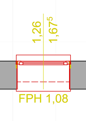

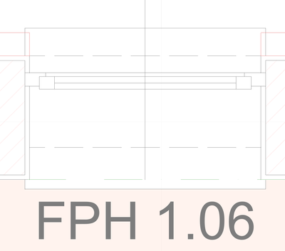

Ideally, we want the opening to show as Existing,

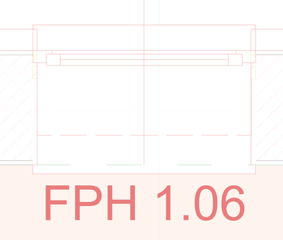

the old window as To be Demolished,
and the new window (but not the opening) as New Status.
What is the correct method to do this? Can two windows (one demolished, one new) be assigned to the same opening, or is there a specific "Replace" function we should be using?

I'm unsure what you distinguish between opening and window, but going by ArchiCAD tool names: you need two windows. One 'to be demolished' for the existing window and one 'new' for the new one.
Existing trim, finishes etc etc etc will all be 'new'. If you want these to remain unchanged, you would have to make an 'empty opening' window (again tool name) and set it up with all the trim etc. If you want to replace a sash inside a frame only, you will have to still have a completely 'new' window (again tool name). You can't demolish one sash.
I hope I understood your question and this clarifies things.
It's a bit clunky and we generally resolve things with extra annotation on our 'demolished' layouts stating things like 'only replace sash, do not demolish entire window'.

You understood the question correctly, and the two-window solution you described is technically what we tried. However, it creates the visual result you see in the attached images: the entire element, including the sill and the wall lines, is displayed as new (in red). This makes it look like we are creating a completely new opening in the wall, which is not the case.
Our specific goal is to have the graphics show:
  • The existing opening and wall in black (existing status).
  • The old window with a demolished style (e.g., yellow or dashed).
  • Only the new window components (frame, glass) in red (new status).
This would visually communicate that we are only replacing the window unit within the existing opening. The two-window method doesn't seem to achieve this level of graphical control.
Does anyone know if there is a method to get this specific graphical output, perhaps through a more detailed status override or a specific "window within a window" setup?
The problem is that in Archicad, the opening and the sill is part of the window object.
Graphic overrides and renovation filter overrides work on the entire element and not just part of the element.
So unfortunately you will not be able to separate graphically the sill and the window, unless you control it all manually.
