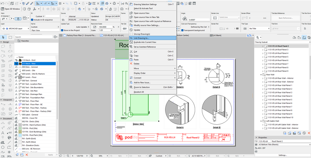

Is it possible to link multiple drawings on a Layout to a new plan view?  Without doing them one by one?
I am doing repeat details with slight tweaks.  The easiest/fastest way is to create a new worksheet.  Then copy the details from the original worksheet into the new one in the same location and make the changes.  Then I can duplicate the Layout Subset which has all the drawings placed on it saving lots of time.  The last step is to re-link the drawings on the layout to the new worksheet. I can right-click a drawing and click "Link Drawing To", one by one.   If I select multiple drawings I can't "Link Drawing To"....which is a huge hassle when you have 50+ layouts and 4 drawings per layout.
In an ideal world, selecting all the layouts in the subset and being able to re-link all drawings on all layouts to the new worksheet would be the best!  Is this possible?

You can if you select them in the Drawing Manager.
Unfortunately, you can't select them on the layouts and have them highlight in the Drawing Manager.
So you have to know which drawings you want by sorting by 'name', 'placed to' or 'source view'.

Barry you legend.  That works fine for me, you have saved me hours of tedious clicking!!! 👍
