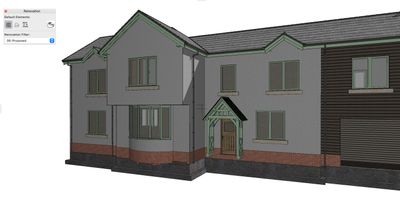

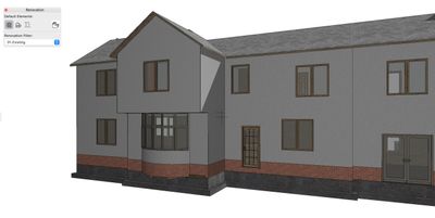

The problem I have with the Renovation Tool is that on some “real world” tasks like putting in a pediment to an existing project becomes such a difficult aspect to model for a client.  Here’s an example.  In this project the house is getting a complete make-over with a considerable rear extension, significant room changes and layout changes to provide a better ‘flow’ through the house in addition to uprating the thermal U values and bringing a 1926 house with 3-4 major shoddy extensions into high spec reform.  This is a classic “Renovation” project.  Most of the ‘renovation’ tool features work ok, but there are one or two that completely fox me.  Perhaps I’m doing something wrong but I’ll try and explain the issue and hopefully someone can either correct the errors of my ways, or perhaps it is just a feature that isn’t yet resolved by Graphisoft.
So, here’s a snap of the existing house with an old window.  We want to insert a pediment above a new window with art stone inserts.  The window is no problem with the renovation tool.
So, step 1 is to ‘demolish’ the old window and ‘propose’ the new window type and opening, as Archicad ‘fills in’ the old window opening and creates a new opening for the new window element.
Next step is to place the ‘proposed’ pediment roof above the window.  So far, so good.
Then I need to cut the ‘existing’ roof to allow the ‘existing wall’ to meet and be cut by the new pediment.  Great stuff, all looks good. However……..
If I now select the “Existing” filter in the Renovation Tool my ‘existing’ roof has obviously been chopped along with the ‘new’ built up wall that is also cut by the future ‘proposed’ pediment.  So frustrating.

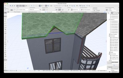

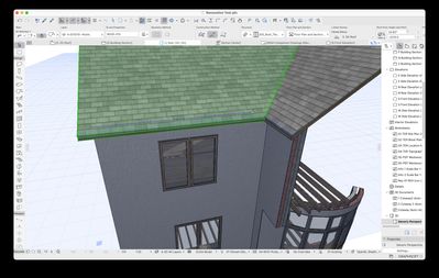

Many thanks for your “pinned” advice.  This solution works well, as the ‘real world’ method of cutting a triangular section out and marking up for demolition created line artefacts that then required further faffing to remove.
The “pinned’ to Existing Renovation layer and copying the roof elements to the Proposed Renovation layer worked very well.  Just wish Graphisoft could include this in future versions.
Before:-
After:-
Thanks again.
