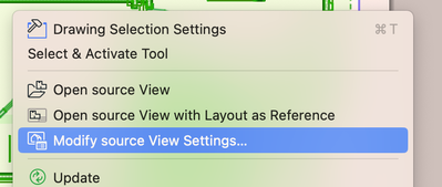

You can right click the placed drawing and select "Modify source View Settings" to change the layer combination.  So, I'm not sure what more you would want to be able to do?

The copy/paste is the problem ... if you work through what Barry, Robert and I have been saying...  by copying and pasting a drawing on multiple sheets, that drawing will always be the same because each drawing is linked to the same source view.  If you change the source view for the drawing, it will change all 7 placed drawings.
What you want (wanted) to do is to create 7 different  views of the floor plan ... where each view has a different layer combination, model view options etc etc... and then place each of those 7 views on the layouts (or relink placed drawings back to the proper views).
This is the most fundamental aspect of using Archicad to produce documentation and I encourage you to read more, and ask more questions until you understand view point -> view -> drawing completely with no doubts, no mystery.  Any less than 100% understanding will lead to problems in your documents.
