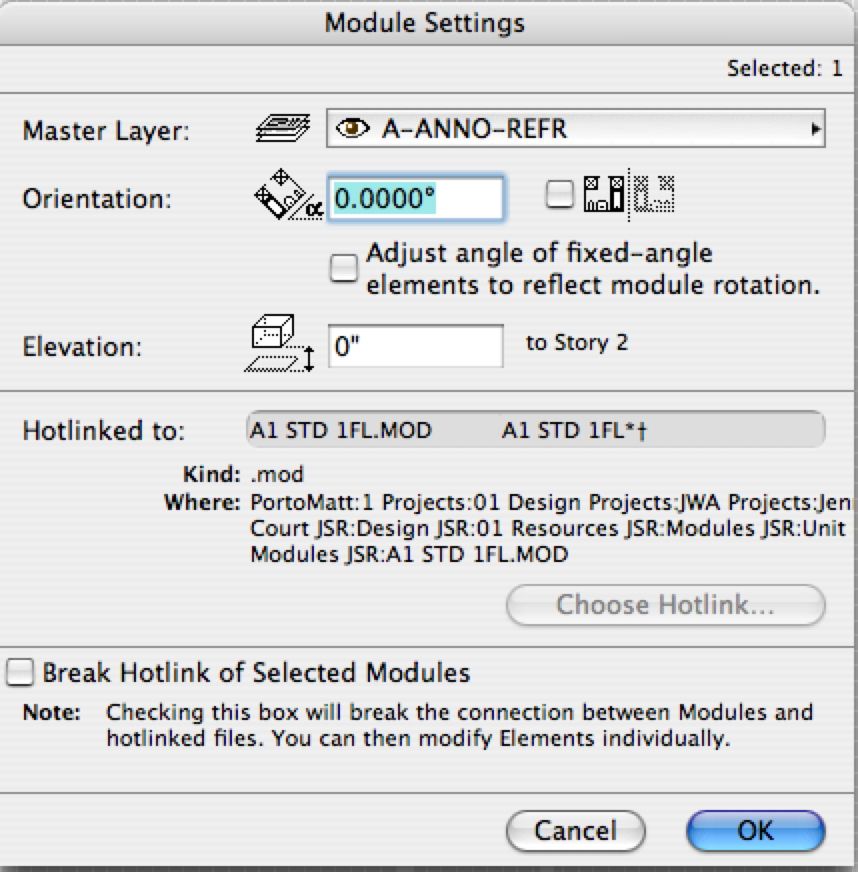

Err I hope I have not been missing something very basic here: you can't change the control layer for a module once it's inserted, right?
Ignacio wrote:
Matthew wrote:
It's probably worth a try. It can always be changed later if there is a problem.
You can change it in the Module Settings dialog.
omg, I had forgotten about that menu item and window long ago
Thanks.
[Those changing menus.]
how do you get to the Module Settings dialogue box after inserting a module? Can’t seem to find a way.
Hassanen
With module selected go to File> Modules and X-refs> Module settings...
