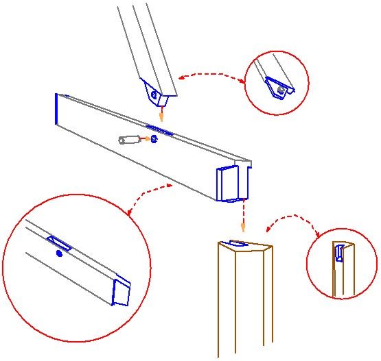

True Ortho Views of Solid Modelled Beams
I introduced this topic a couple of years ago but still have no solution.
Suggestions then involved cut & paste from the 3D window, which is not an ortho view so can't be used to dimension.
I created these beams with solid modelling so they show as sqare boxes with dotted lines in plan view.
I need to communicate the exact dimensions of the cuts to the guy with the beam on the sawhorses.
With sections, I get the "vertical" dimensions, including the notches (have to cut & paste to get the interior dotted lines & exterior solid lines in one sect/el).
But I need to get the dims on the "horizontal" measurements.
The only way to do this (I think) is to lay the object on it's side in plan & use the sect/el tool.
ROTx 90 does this if you want to edit every beam, save a "laid-down" version, place them around the plan, add sect/els for each.....
Like the RCP issue, it gets a bit nuts & moves away from one model.
Anyone with ideas, please?

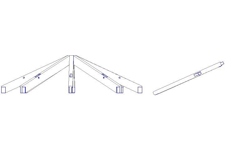

ROTx 90 gives this so I guess you also need to rotate the slope out but I still got the next one by rotating the lines in a detail.
This is from a detail window after saving the object, ROTx 90, placing the new object in plan, setting up new sect/el, making a detail from the sect/el and rotating the lines to the horizontal.
Can we not see an object like this from the top & bottom without the pain?
This one was easy from one section.
