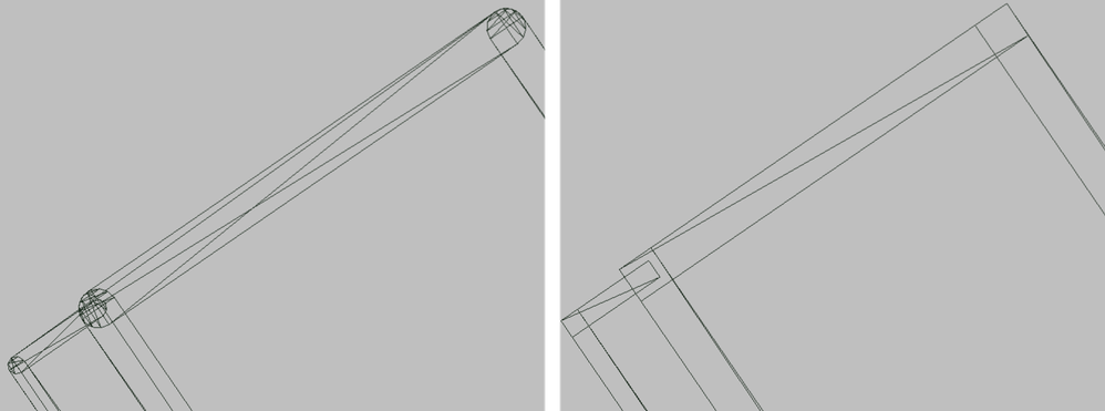

The strength of the algorithm is that it can render round caps (in fact any type of cap) for free. In the legacy implementation caps were done by calculating the actual geometry, which meant unnecessary memory usage and segmented look at high zoom levels.The legacy implementation (left) had to manually generate rounded caps, whilst the new one (right) calculates them during rasterizationThe legacy implementation (left) had to manually generate rounded caps, whilst the new one (right) calculates them during rasterization
