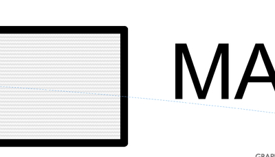

Hello, I am making a new template for Archicad 24 and I have run to this problem. I have already done a lot of work, but I provably made some mistake (I do not know where) and now all my fills and materials are displayed in a wrong way. Hatches are not shown according the measure and lines are too closely next to each other. I checked Attributes Manager but even when I changed some properties, changes did not applied (show according measurement is checked). How can I change my fills and builiding materials to defaul in my template? Is it possible?
Or maybe how can I import and export fills from default version of Archicad into my template? Maybe there is a better solution, I will be grateful for all advice. In addition there is a foto of my problem.

This looks to me like a display thing. Try turning on "Vectorial Hatching" under: View / On-Screen View Options / Vectorial Hatching.

This could depend on many possible wrong settings. Maybe you have some graphic overrides applied?
You can always use the Attribute Manager to import fills, linetypes, etc., but depending on how far you have your template developed, this can also cause new problems. Take a look at this Archicad tweet - a template development should always follow this pictured steps.

Thank you so much, it worked.
