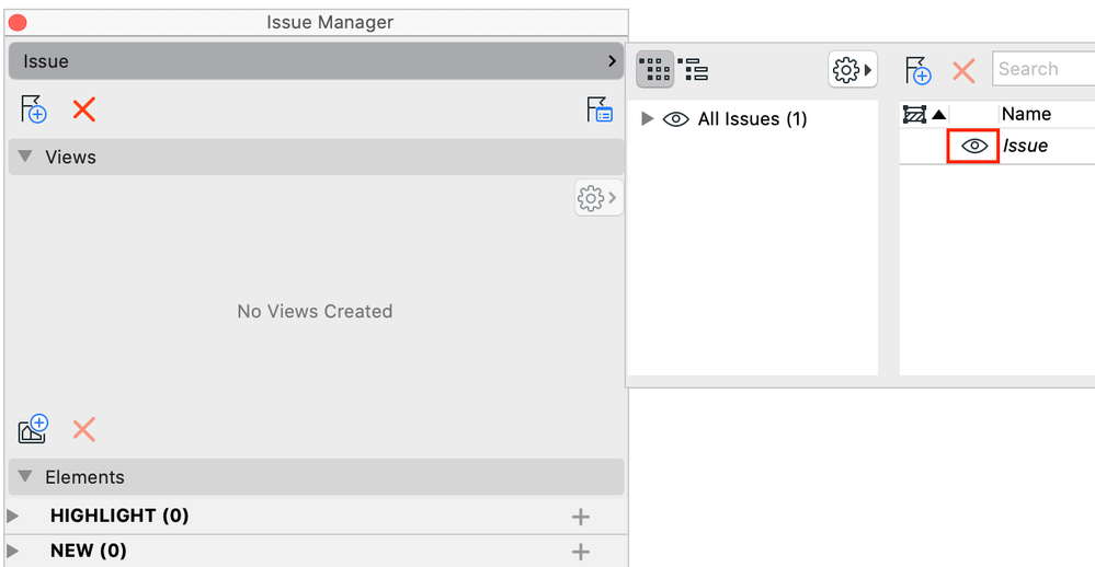

Affected versions: Archicad 24 | Severity: Fixed in an update | ID: DEF-3085
We have discovered a regression issue with Archicad 24 Update 4007, Archicad 24 Solo Update 4004 and the Archicad 24 Releases of the CHE, CHI, GRE, KOR, TAI and UKR versions.
Issue: If the Issue Manager is in use (an Issue is turned on by having the eye icon open) then creating a Detail Viewpoint in a Section or Elevation that has a Dimension placed will result in accidentally deleting all Project Map Viewpoints except for the Floor Plan Viewpoints. With the Viewpoints getting deleted, the Views originating from these Viewpoints will also get removed from the Navigator.
Cause: This issue occurs as a side-effect of a related bugfix that has been implemented for the 4000 Build series of Archicad 24.
Workaround: Turn off all the Issues in the Issue Manager for the duration of opening the created Detail Viewpoint for the first time and when applying the "Rebuild from Source View" command on a Detail Viewpoint to circumvent the issue.
Solution: This issue has been fixed from Archicad 24 Update 4018.
