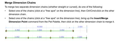

In this video for @Luca Manelli, he was describing a new feature (for me) regarding Dimension in a short clip shared via linked-in.
Kindly, If any one can help me understand it, thanks in advance.

Yes, this feature called (Merge Dimension Chains), since Archicad 19 & earlier but I never heard about.
*Here’s the video explaining it in more detail.
https://youtu.be/er6DoaYuXno?si=274EnJvOUESjhF8B

It's the regular dimension tool. Here's a short how-to video in english: https://capture.dropbox.com/Mya6QlymMZ3k0IAD
*edit: to correct and clarify the instructions:
1- select dim 1
2- press+hold: cmd (for Mac) / ctrl (for win)
3- select dim 2
2 weeks ago

I need to know the name of this feature, where is it in the help guide? Is it included in pet pallete?
2 weeks ago
In the Help manual, I believe it is under
