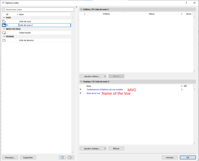

Diseno14
Could you create a view index and change the mvo from there?

BrunoH
You can simply create a view index that will show you the missing MVO and replace them there.

I now have the issue in another TW project but your trick does not help!
Not sure why not tho. The views are missing their MVOs, but this won't show in the schedule at all. Instead it just shows the regular name of the missing MVO.
I suspect that in your case you actually renamed "10 Affichage Projet" to "10a Affichage Projet Plans", and that's why it went missing.
In my case however the MVOs aren't really missing. So e.g I do have the MVO named "10 WIP" but it stills shows as missing in the view itself, however since the name actually exists it does not show this information in the schedule contradicting the view. But that's just a guess.
In any case this is deeply broken for ages now....

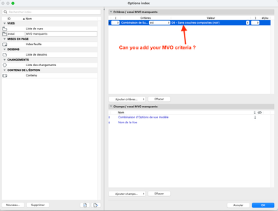

Hi Runxel,
in the views index can you add the MVO with the "10 WIP" as a criteria ? does it the list the views ?
can you then change the MVO ?
 I suspect that MVO are compared by names, not by indexes like other attributes and that characters encoding can cause the problem.
For 3 years or more, i am facing strange issue with names, not only with Archicad. This problem occurs when transferring files from MacOs to Windows.
For example when transferring a file from MacOs to Windows via  my Google drive this end-up with 2 files with the same displayed name (the old version one not replaced with the new). I think of this characters encoding issue when transferring files in the other direction that have names containing special characters, the names were modified, each special character replaced by a sequence representing it's encoding.
ArchiCad 3.43 to 28
MacOS Monterey
Yes it shows all of them, even when it the view says its "missing".
