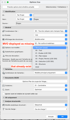

I have a number of views whose MVO settings have gone "Missing" (although they still exist). I know this has been a longstanding issue since at least Archicad 25. But now I am tasked with going through each view and relinking the MVO settings, but I can't seem to find a command to open "View Settings" in the list of possible shortcut commands (in Work Environment > Keyboard Shortcuts). If there were I would give it a shortcut to be able to quickly go through an open each views settings. Does this exist?

So you end-up with a situation like this
 For me this is a bug Graphisoft should address.

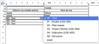

However, as a work around, If your views are from a clone folder, change the MVO setting of the clone to another one then return to the right one, all views in it will be amended.
If views doesn't belong to a clone, you can list them with a view index list with the MVO as a criteria,
 then change the MVO to a different one then again to the right one, for each listed view in the same way as for the clone.
