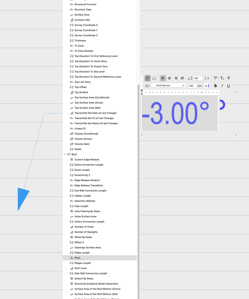

Gerry Leonor
i've created a couple of Properties to call up a few things:
the pitch is a simple callup from the Label tool.
the first two (percentage & ratio) are from the 2 new properties i've created:

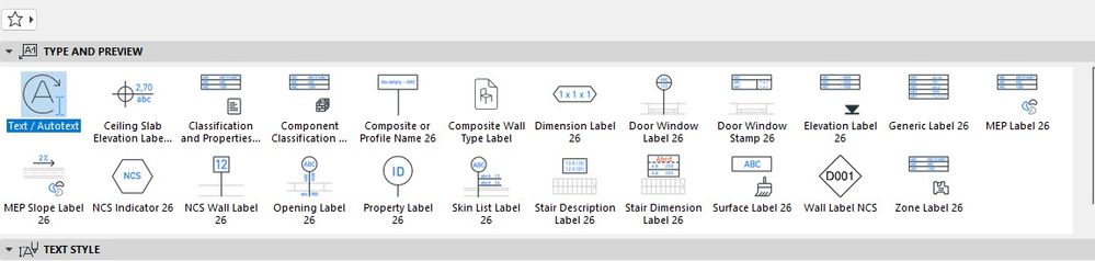

The default labels tools that I have do not show an option for the roof pitch. How to add a roof label?  Also, I don't know how to create properties.

Thank you, Kim! If I hover over the roof, I can read Roof Pitch: -2.39 but I want to show a ratio like
(1 : 12). Also, the label tool that I have in the pet palette does not have the pitch option.

Gerry Leonor
for the properties, i would suggest watching the video below.
ARCHICAD Tip - Calculate Beam Slope - YouTube
that can give you a good primer on how to create properties for the Slopes.
regarding the pitch, i don't have AC in front of me right now, but when you're in the middle of a Label text box, click on the @ symbol (top left corner), this should open up a directory of the various properties that can get called up in a Label tool. search for "Pitch". it should belong under Roof. Double click it & it should create a some text. if you created the label text box while hovering over a roof, the new text will reflect the slope, otherwise it will come up with some coding jargon & will keep displaying as such, until you've re-linked that label to a placed Roof element.
