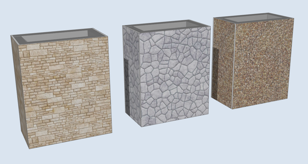

Have a look at the stonework surfaces that are in the standard template.
They have a surface texture image that you can see in 3D and renders.
As well as a hatch pattern (fill) that you can see in elevation.
So no need for separate fills, unless you really want to.
You might be able to load more surfaces from the surface catalogue or additional surface catalogue if you have  access to that.
Or you can create your own.

Beside the suggestion by Barry Kelly I can say that generally is good to model the stone cladding separately for a better control of the height of the cladding, of the distance from the supporting wall, etc ... In this way you can consequently control better the quantity take off.
