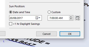

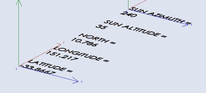

I'm trying to create a 3D object for use in Sun Studies that will show the current 3D window time and date as well as sun azimuth, altitude and project location (Obviously not casting shadows... ) I can get most of the information i need except the Date and Time. Using the GLOB_PROJECT_DATE is apparently only set for EcoDesigner.
Am I missing something simple? Any ideas??

That's what I thought... I need the current time/date with in the 3D Window/3D Document to show in conjunction with the shadows.

I've been able to get the sun information which will update from image to image, it's just the time / date I have issues with..
