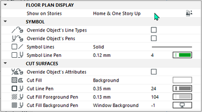

Can the expression of the current floor and the upper floor be different in 2D Script?
LeeJaeYoung
I want to know if it is possible because it seems to be expressed like that on the stairs.
I just want to know if it is possible to show the current 2d script in position.
What I want is to be able to express different expressions on the upper and lower floors like the stairs. ^^

kuvbur
Yes, you can, with GLOB_CH_STORY_DIST
EPS = 0.00001
if GLOB_CH_STORY_DIST > EPS then
	!upper  floor script
else
	if abs(GLOB_CH_STORY_DIST) < EPS then
		!home floor script
	else
		!down floor script
	endif
endif
