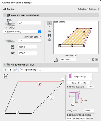

This would be the top of my wish list for GDL features - a "ui_poly". For me it would save so many little png's I have created over the years. And for this sort of thing, create a much nicer UI..
I just released an update to my roof accessory. I found a slightly better work around for creating a polygon in the UI.
I found the 'dot' method a bit slow and un-sightly - particularly on PC
Rather than create dots that get repeated, I create a few png's, about 10px by 10px with a diagonal line across them. So I only need to place 4 or 5 per segment.. here are the results. Looks pretty neat - even when the line is not a 45 degree angle...
