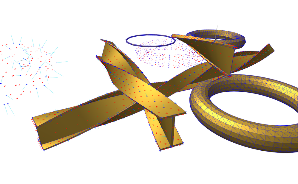

rudl
Parametric torus and bended beams.
Torus example:
theta = 360/u
FOR i = 2 TO u
	vec_temp[1]=po_s[i-1]
	GOSUB "V_ArotX":
	po_s[i] = vec_temp[3]
NEXT i
FOR i =1 TO u
	po_s[i][2]=	po_s[i][2]+rv
NEXT i
theta = 360/v
FOR i = 1 TO v-1
	FOR j = 1 TO u
		vec_temp[1]=po_s[(i-1)*u+j]
		GOSUB "V_ArotZ":
		po_s[i*u+j] = vec_temp[3]
	NEXT j
NEXT i
c =0
FOR i = 1 TO v
	FOR j = 1 TO u
		IF i = v THEN
		IF j = u THEN
		c = c +1
		f_pi[c][1]=(i-1)*u+j
		f_pi[c][2]= j
		f_pi[c][3]=(i-2)*u+j+1
		c = c +1
		f_pi[c][1]= j
		f_pi[c][2]= 1
		ELSE
		c = c +1
		f_pi[c][2]= j
		f_pi[c][3]=(i-1)*u+j+1
		c = c +1
		f_pi[c][1]= j
		f_pi[c][2]= j+1
		f_pi[c][3]= (i-1)*u+j+1
	 	ENDIF
		ELSE
		IF j = u THEN
		c = c +1
		f_pi[c][2]=(i)*u+j
		c = c +1
		f_pi[c][1]=(i)*u+j
		f_pi[c][2]=(i-1)*u+j+1
		ELSE
		c = c +1
		f_pi[c][2]=(i)*u+j
		c = c +1
		f_pi[c][1]= (i)*u+j
		f_pi[c][2]= (i)*u+j+1
	 	ENDIF
		ENDIF
	NEXT j
NEXT i

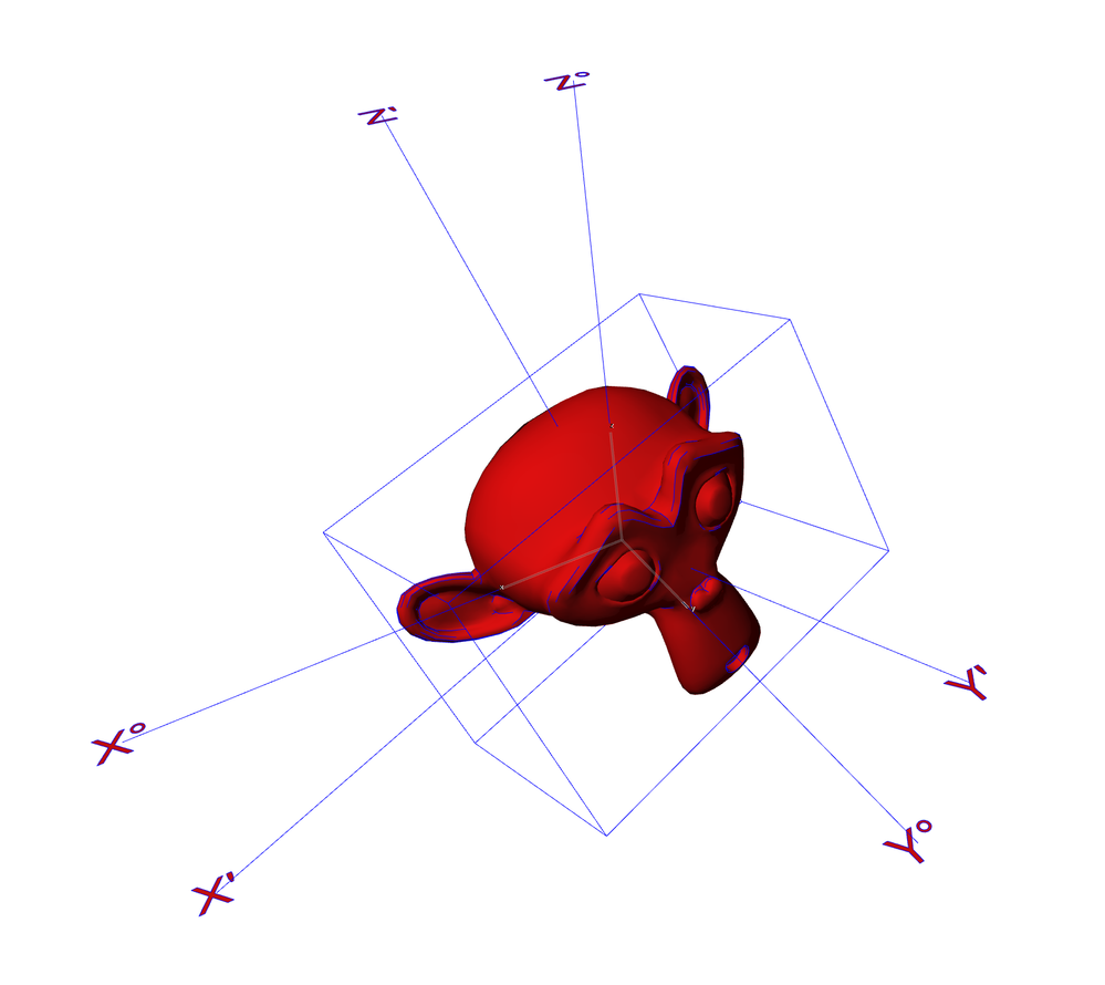

rudl
*) Monkey read from text-file
*) Arbitary rotation around an axis rodriques transformation
*) Display Helper Axes
