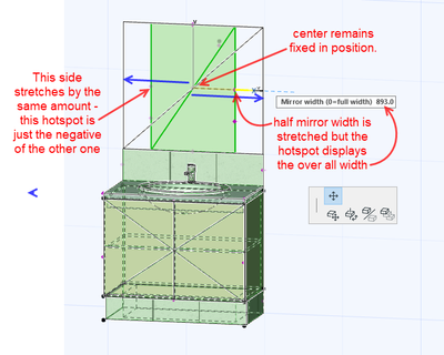

If C stays in a fixed position and A & B are equal on each side, then it can be done.
I have done it with my vanity mirror.
Otherwise you could have a 'length_A' and 'length_B', both with their base at C, that can be adjusted independently.
But then C would not be in the middle.
You would have to re-calculate C to get the middle distance and then apply that to both 'length_A' and 'length_B', changing their values, so C is in the middle again.
I think that will be the tricky bit.

You can have many hotspots on the same parameter, in any directions. Maybe technically even angle and stretch too, but that doesn't make sense 🙂
The half width and the full width have to be different parameters if either of hotspot, input or listing is needed on both.
