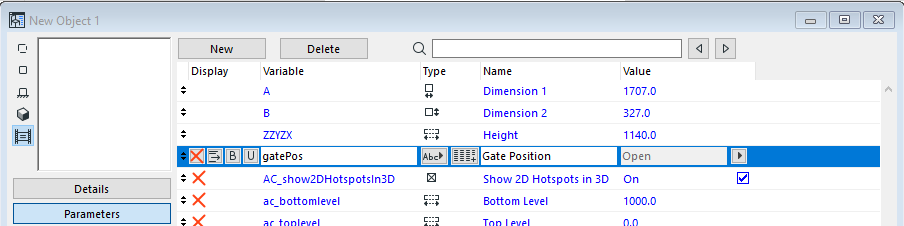

I have 1 single object with multiple models in it and I learned how to switch between the different models. My problem is that the models in the object have different dimensions which all should be fixed. I am sure I can figure out how to make the dimensions fixed and unchangeable, but what I couldn't find an answer to is how to make sure that the placed object's dimensions are set to the picked model. At the moment, all the other options are stretched to the same size as the first/default model. Ticking the box for 'Use Stored Environment' does not do anything to this.

gatePos is an Abc variable (text) in the parameters list
you have a line in the master script or the parameter script giving a list of values
then this bit of script should work
when you change the value in the parameters view, a,b,zzyzx will automatically change

parameters a and b are the values in the info box
remember the units in the gdl script are in meters

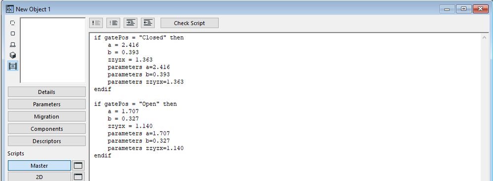

I have this in the Master Script and when checked it says ok, but the object in option 2 (Open) is still stretched:
if "gatePos" = "Closed" then
a = 2.416
b = 0.393
zzyzx = 1.363
parameters a=2.416
parameters b=0.393
parameters zzyzx=1.363
endif
if "gatePos" = "Open" then
a = 1.707
b = 0.327
zzyzx = 1.140
parameters a=1.707
parameters b=0.327
parameters zzyzx=1.140
endif
LOCK "A"
LOCK "B"
LOCK "ZZYZX"
I am not sure what could be a problem. The origin of the models in the object were morphs save to individual objects and then their 3D scripts were combined. Not sure if this matters for the outcome.

I tried Allan's suggestion, but it doesn't seem to work, so I will try with yours.
So you are saying I should remove these lines?

the variable name for the if/then statement.gatePos should not be in quotes.
this will work:
if gatePos = "Closed" then
    a = 2.416
    b = 0.393
    zzyzx = 1.363
    parameters a=2.416
    parameters b=0.393
endif
if gatePos = "Open" then
    a = 1.707
    b = 0.327
    zzyzx = 1.140
    parameters a=1.707
    parameters b=0.327
endif
this assumes that
also
endif
these asks if the word "gatePos" is the same as the word "Closed"
which always gives you a False answer
endif
these asks if the contents of the variable gatePos is the same as the word "Closed", i.e. it replaces gatePos with "Closed" or "Open"

Those are indeed the lines in question. The number on the right side will be the original objects dimensions, so when it is set, your object is not scaled, but when you change A & B in the case of your alternate objects, these will no longer be equal to 1 and hence stretch along the relevant axis.
Ling.
