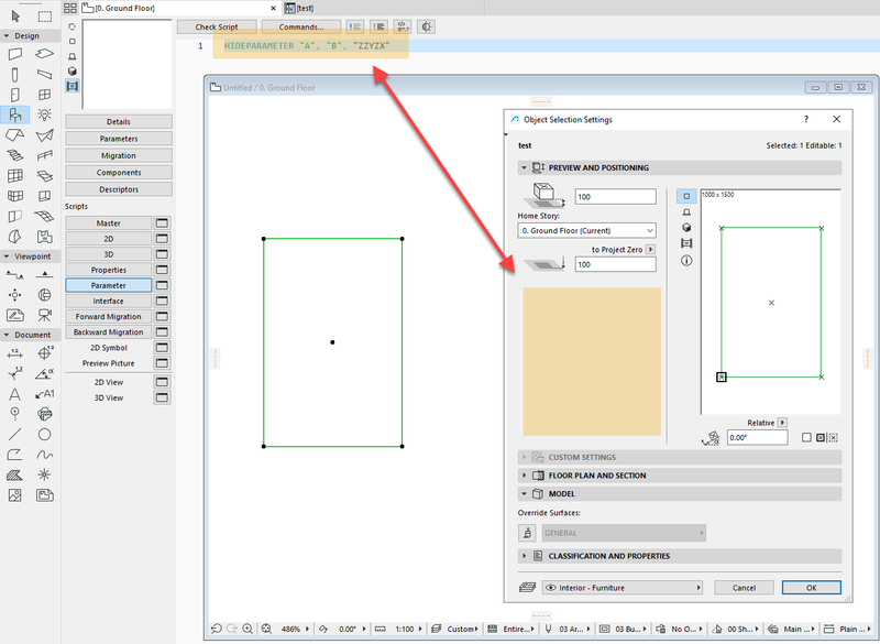

I thought HIDEPARAMETER could hide "B" (and zzyzx, A) in the object settings in Info Box –I thought I had done it repeatedly in the past. It is not working on AC27. How do/did I do that then?

For me it works in Parameter and Master Script:
HIDEPARAMETER "B"
HIDEPARAMETER "A"

Works fine for me as well in Archicad 29. I tried it in Archicad 27 INT as well, and it works for me.

Oh my, SORRY, spelling mistake in the variable used for IF-THEN. Thanks for helping me catch, still.
