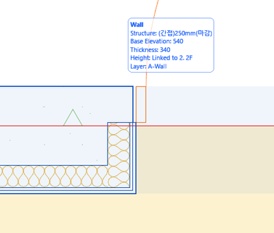

How can I do it like fit to skin? sect_fill "insulation 01"

runxel
Is that in the floor plan?
If so, script it with a poly2_b{5} and use the distortion matrix.

LeeJaeYoung
I am trying to create insulation in 2d script.
what you said
"Is that in the floor plan?
If so, script it with a poly2_b{5} and use the distortion matrix."
Can you please explain in more detail about this?
1. Where can I find sample code using poly2_b{5}?
from window.gsm
2. How many values do I need to bring from wall_skins_param to create insulation?
I only brought the fill type... ^^
3. Can you elaborate on the use of the distortion matrix?
4. This is the insulation I am trying to make.
