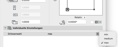

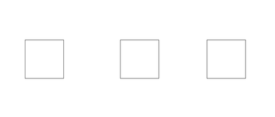

Hi Barry,
I tested it too, but every rect2 is always 1.00/1.00 and not of the A and B size..... !?
With Lock "A" and "B"... doesn't matter.....
ArchiCAD v6.5 - 28 (CHE Swiss Edition) - macOS / WIN (Switzerland / Schweiz)
